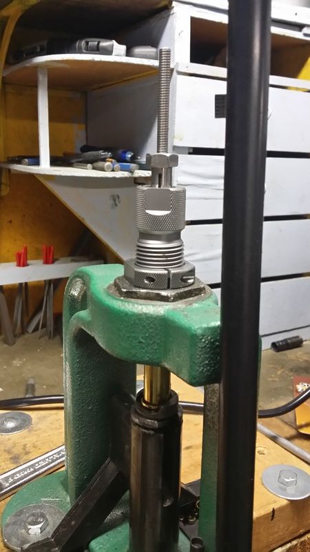

Next I lube the case and run it up into a .45 ACP sizing die.
[Image: 20170118_091416_zps2b8qi80c.jpg]

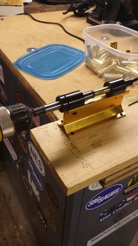

Now into the case trimmer for an accurate length of 1.42"
[Image: 20170118_092506_zpskg55lsmx.jpg]

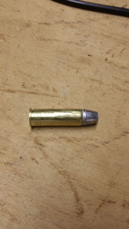

Primer is seated, (large magnum rifle), case mouth is expanded and 36 grains of Goex 3F is poured through the funnel.
A .030 Walters wad is placed on top of the charge and a compression die is utilized.
Bullet is seated. A 300 grain soft lead bullet from an Accurate mold sized to .446 and lubed with Sagebrush black powder lube.
Lee .45 Colt factory crimp die.
The end result. Whew!
[Image: 20170118_093450_zpswcsxnzhb.jpg]
Just for a comparison a 44/40 with 200 gr. bullet. A .45 Colt with a 255 gr. bullet and the 11.75 with a 300 gr. bullet. Most people considered the .45 Colt to be the magnum of the day. It was pretty much the most powerful revolver round. The most blackpowder that I have ever gotten into a .45 Colt case is 34 grs. and that was with a drop tube and heavy compression under a 255 gr. bullet. The 11.75 takes 36 grs. easily with light compression and a wad under a 300 gr. bullet. I think it would probably take 40 grs. easily. The Austrian Gasser revolver came out and was issued in 1870 before the 44/40 and .45 Colt. Quite a banger I think.
[Image: 20170118_093717_zps6bvlhbtn.jpg]
